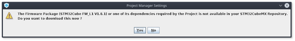

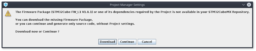

Posted on January 25, 2018 at 20:06
I installed the CubeMX as a separate (separate folder - I had the previous version already installed), standalone application.

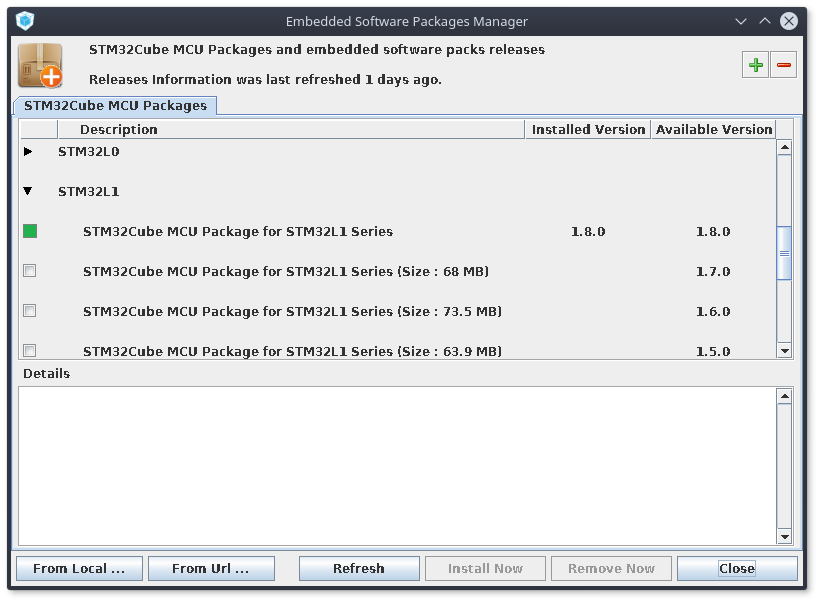

I started the application trying to keep the version 1.8.0 of L1 (already installed) untouched but the program refused to generate the code saying that the 1.8.1 version of the driver must be downloaded - I unplugged the network cable to avoid Internet connection. But started to show in cascade several dialog windows with complains. So I proceeded as advised and allowed the download of 1.8.1. Unfortunately, that started with a redownload and a rewrite of 1.8.0 version (I saw the configuration files of CubeMX and how the 1.8.0 was marked) - so I got upset. It should have created a new folder for 1.8.1 version only.
I had a backup of 1.8.0 and installed it using the ''From Local...'' button, I uninstalled the 1.8.1 version but it still complained as the 1.8.1 version is marked as new in the database. There is no option in the graphical interface to set the default working version driver or I don't know it. I only wanted to check the Cube functionality regarding reported bugs and not a new version of the driver (when I will need it, I know from where to get it).
But I solved the problem so, no more complains from my part
