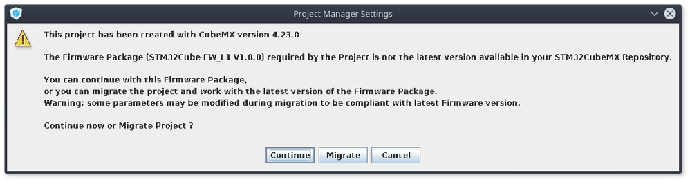

Posted on January 26, 2018 at 02:46
After I managed to make the Cube believe that the 1.8.0 is the latest version and changed the update checking to ''Manual'' and no refresh at a new start, after a new start I got this message (but the program let me continue with the regeneration of the project)
So, it seems that continues to talk to the server no matter what settings you have. And here is a part from the log file:

Posted on January 26, 2018 at 05:04
Nope, pressing 'Migrate' won't force a bigger (does not say a thing about 1.8.1 and won't try to download it - exactly what I wanted, but what I did is not what an user will do, and surely not recommended by ST) version than the one from the repository, which is 1.8.0. So no 'destructive' effect. It remains to be seen how it acts when a new version is on server. If it will announce that to the user,  or the settings about network access are really effective...
