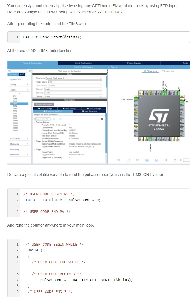

Hi All,
First post :beaming_face_with_smiling_eyes:
I want to count external pulses with a STM32F105 or STM32F405 using the HAL library.
I want the external pulses to increment the timer counter.
I want to avoid using interrupts. Instead, I want to read and clear the timer counter within a round-robin.

The code below uses Timer2 and PA0 as a clock source. Unfortunately, it doesn't work :\

KnarfB
January 22, 2023
Input Capture (IC) captures (copies) the timer counter to a timer channel register, this is not what you want for counting pulses. You want to use ETR (external trigger) mode creating counter pulses from an external pin and read out the timer counter register.
Have seen projects on the web, your search engine will find them.
hth

Lee Davies
January 22, 2023
Thanks KnarfB,
Found a post detailing how to use ETR to count pulses. It worked a treat :beaming_face_with_smiling_eyes: :
I know it's a little wasteful, but I have plenty of timers ;)
