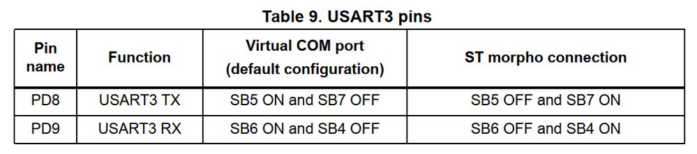

How to locate the PD8 and PD9 port pins on the nucleo 144 STM32F429ZI for external USART3 interfacing with the TTl to RS485 converter. A brief explanation of the config of the SB (solder bridges) connections will be nice or where to get more information.

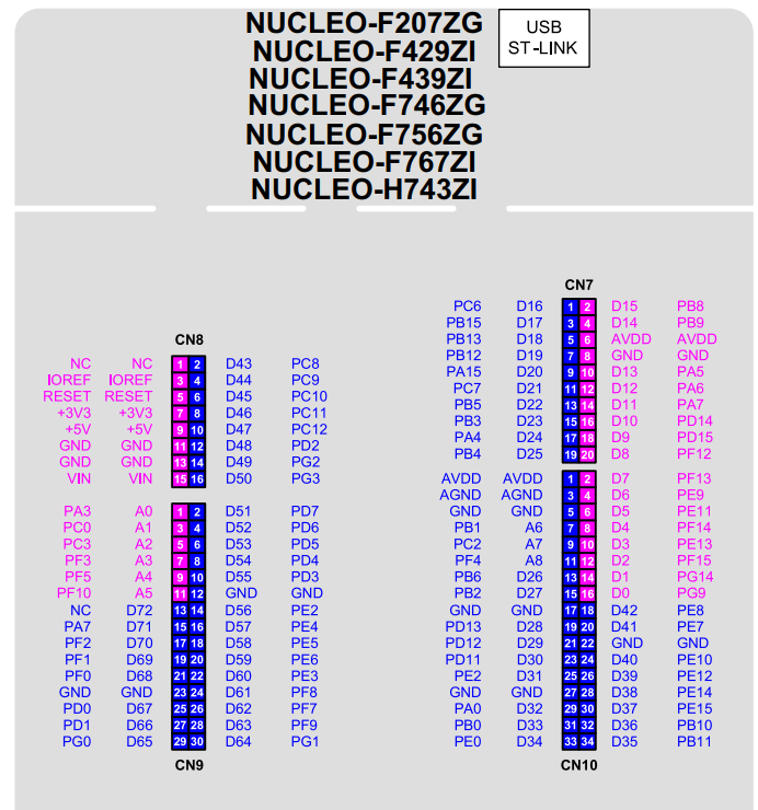

The Nucleo has two rows of holes on each side. There you'll find the pins not routed to the black connectors.

Just have look at the board's manual - you will find all the connectors and config options there.

I am actually new to stm32 and perhaps there is
something am missing. The user manual says UART3 is linked to PD8 and PD9 but on the extension connectors diagram, I cant find PD8 and PD9.
‎2023-01-22 4:25 PM
Got it thanks
