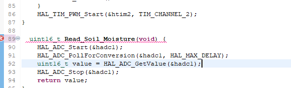

I'm trying to make a smart irrigation using stm32f407 so, i used a Soil Moisture Sensors
i write my code but when i trying to run the problem is :Description Resource Path Location Type conflicting types for 'Read_Soil_Moisture'; have 'uint16_t(void)' {aka 'short unsigned int(void)'} main.c /Projectrrr/Core/Src line 89 C/C++ Problem
and this is my code:
so how i can solve this problem

Andrew Neil
Please use this button to properly post source code:
Please post the full text of the message - copy from the 'Console' window, and paste here.
The full message should tell you both what type it was expecting, and what type it actually got - you've only posted the bit saying what it's got.

Lacking in contextual detail.
You've probably defined or used it earlier and the compiler used that.
Check .H files and any instance where you might have created a prototype or used it previously.
Used it on line 21 and compiler guessed, you need a prototype or definition before first usage.
uint16_t Read_Soil_Moisture(void); // prototype first, and early
You didn't show the full message!
In fact, please show the full build output - that will give more info.
EDIT: This is the 'Console' window - copy from here:
As @Tesla DeLorean said, likely you are calling the Read_Soil_Moisture() function before you have declared it, so the compiler will have created a default declaration.
There should be a warning about that.
Probably, the default declaration doesn't match your actual definition - hence you get the error when the compiler reaches your actual definition.
This is a good example of why it's important to handle compiler messages in order - starting  with the first one reported.
Note that this is general C stuff - nothing specific to STM32
Pavel A.
In line 21  Read_Soil_Moisture() called without previous declaration. Either move this  function up before main(), or add the prototype declaration after line 8.
