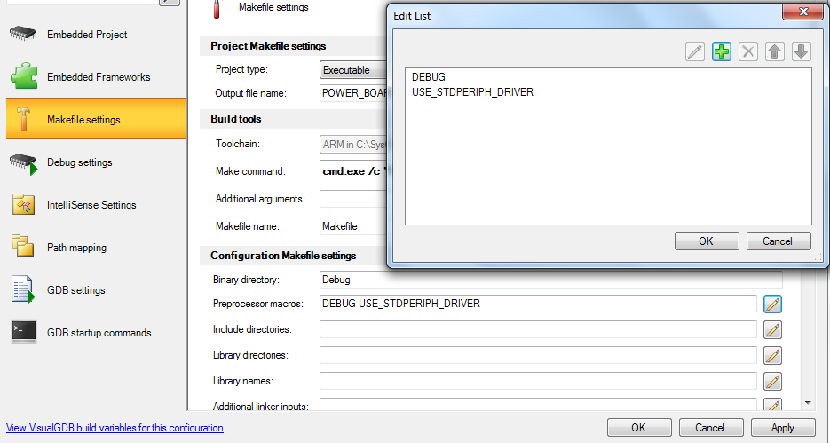

After this failure, which I did not know how to solve Itried to use some examples what I found here, like in [DEAD LINK /public/STe2ecommunities/mcu/Lists/STM32Discovery/Flat.aspx?RootFolder=/public/STe2ecommunities/mcu/Lists/STM32Discovery/UART%20example%20code%20for%20STM32F0&FolderCTID=0x01200200770978C69A1141439FE559EB459D75800084C20D8867EAD444A5987D47BE638E0F&currentviews=38320]this thread. Especially clive1 post at 6:42, but I have same problem as that guy with NVIC_InitTypeDef beingundefinied. I added preprocessor macro, butNVIC_InitTypeDef is still undefined. 0690X00000605GZQAY.png I have configured the USART4 and I know I have to write theUSART4_IRQHandler(void) , but how to configure/enable this interrupt? Can someone please help? #usart-interrupt #st32f030cc

USART interrrupt (and interrupts from other peripherals) has nothing to do with EXTI. There are plenty of examples o the net. To enable the interrupt, configure it in USART control registers (RXEIE bit), then call
NVIC_EnableIRQ(USART4_IRQn);

Thanks! I guess I should read more about interrupts and find a solution to
NVIC_InitTypeDef being undefinied.

Suspect you need the right startup_stm32f0xx.s file, and the define for your CPU line.
Somehow I think you are mixing EXTI# with Cortex-Mx vector numbers.
