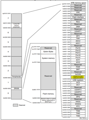

Concurrent use of USB and CAN with STM32F105
ssunlove
Sarra.S
Hello @ssunlove

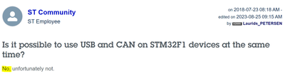

The link you're mentioning: Concurrent use of USB and CAN with STM32F103
Unfortunately no, the USB and CAN can be used in the same application but not at the same time on all the STM32F1 series, including the STM32F105R8T6.

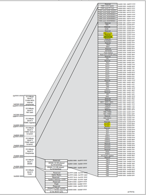

Then is STM32F2 possible?
Sarra.S
Yes, you can check this information by looking at the memory mapping in your product datasheet
For STM32F1 series: There is a shared 512-byte SRAM between USB and CAN
For STM32F2 series: it has separate USB and CAN peripherals
