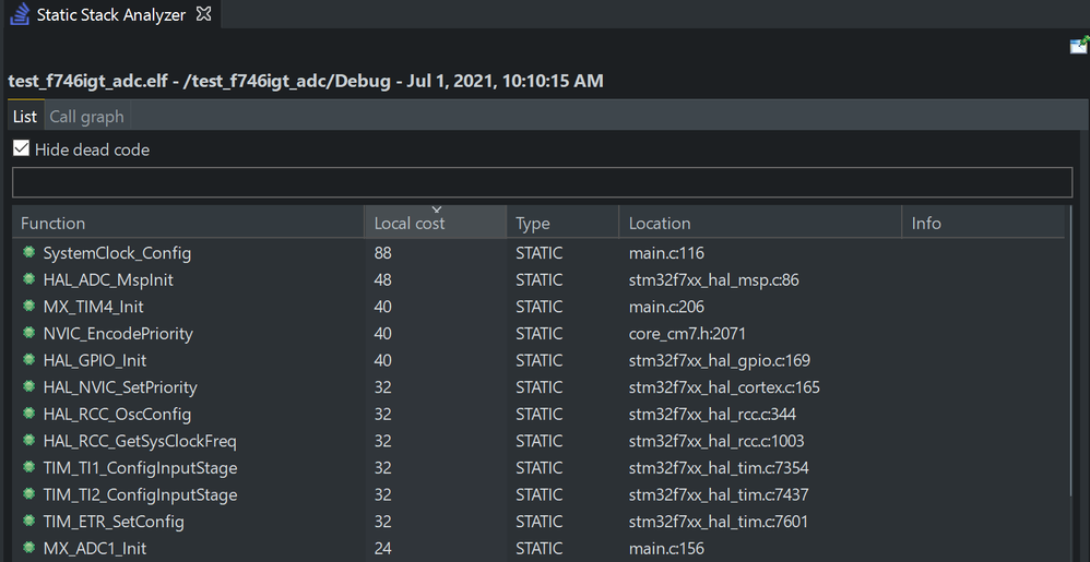

‎2021-07-03 10:10 AM
You can use the stack analyzer in STM32CubeIDE to verify you're within whatever limit you set.
There's no runtime specific check that can be done here.

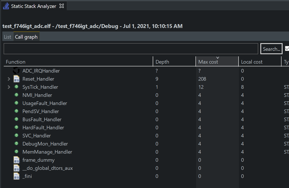

The call graph based usage is especially useful:

‎2021-07-03 10:15 AM
Yes, I can see the local cost. But how to ensure it fits when it's, ex. 1KB?
Some functions might be stacked, so also their stack sizes.
Anyways, how do I know if the system ram has enough space for it?
Maybe by adding the compiler ram usage report+function stack cost?
Thanks
‎2021-07-03 10:25 AM
You manually check that the sum of the "max cost" of all IRQs that can be called at once is less than what you have allocated for your max stack size.
The call graph includes overhead for functions called by other functions. For example, Reset_Handler includes stack used by main(), as well as functions that main calls, and so on...
