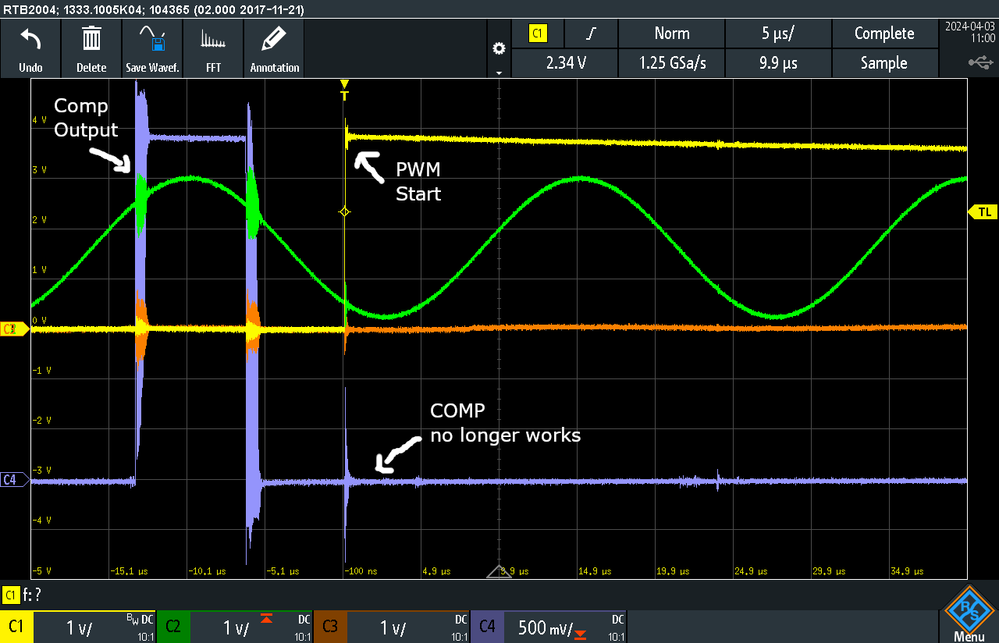

If I don't enable the blanking function in the comparator setup, the system works fine:
  • The comparator output works as expected
  • The PWM channels (TIM2_CH1 and TIM2_CH3) work as expected.
After enabling the comparator blanking function on TIM2_CH3:
hcomp1.Init.BlankingSrce = COMP_BLANKINGSRC_TIM2_OC3_COMP1;
The comparator output stops working and the TIM2_CH3 channel does not seem to be affected by the comparator.
A strange thing, if I don't start the TIM2_CH3 the comparator output works fine (even if the blanking function is enabled).
What am I doing wrong?

FlavioB
I add an osciloscope image to better explain the text above

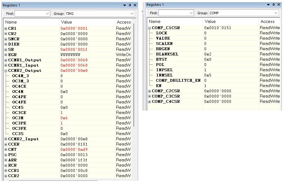

FlavioB
I also attach the TIMER and COMP register, they seem to be configured well:
I'm starting to suspect a bug in the hardware design of the STM32G431 ?
