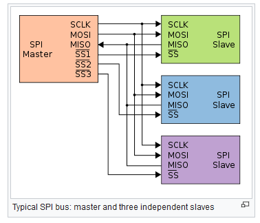

I have one more question: Will SPI port from the mentioned MCU support 8 slaves without any problem of bus loading or something like that?
The SPI configuration is a typical one as mentioned in picture below (but with 8 slaves) and not daisy chain:-

Ozone
Principal III
Check the slave's datasheets.
When you communicate with one slave any time, the others are supposedly only a capacitive load.
Non-seselected slaves shouldn't pull any significant current.
