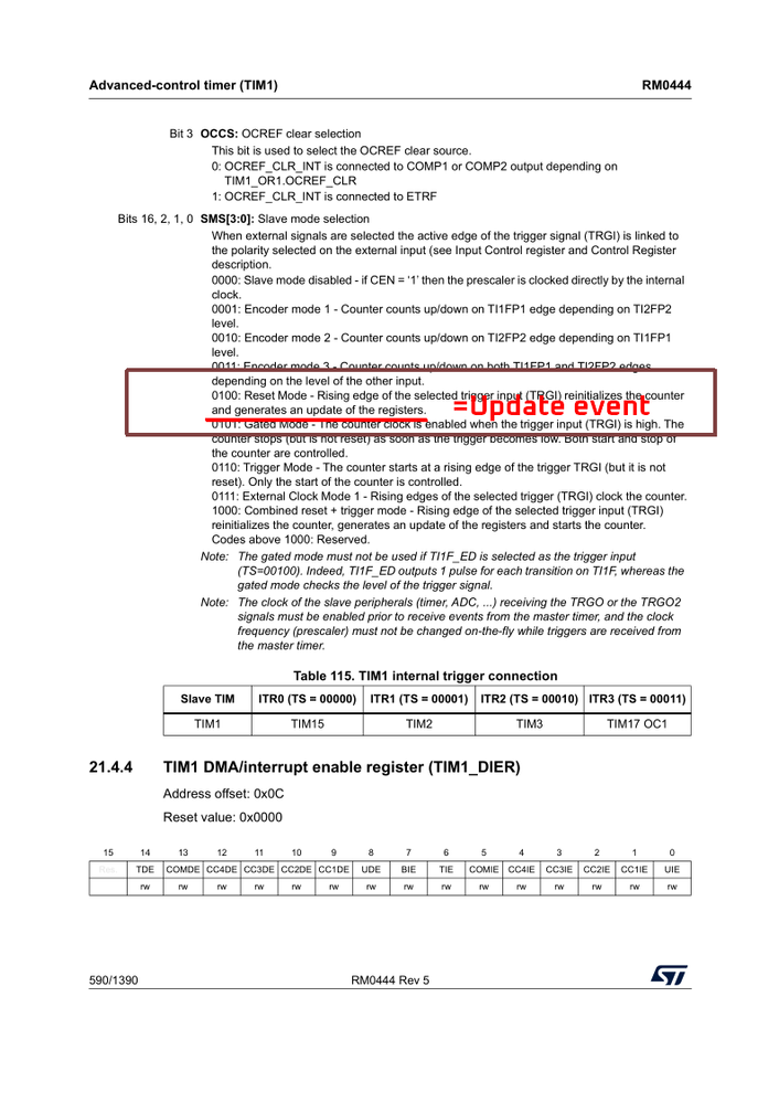

When TIM1_CC_IRQHandler is called the TIM1->SR register is always 0x30059 (110000000001011001), which means UPDATE and CC3-CC6 are set, even though they are explicitly disabled. On the other hand CC1 and CC2 are never set, even though this is Capture IRQ handler specifically for these events.
When TIM3_IRQHandler is called the TIM3->SR register is always 0x1f (11111), which means UPDATE and CC1-CC4 are set, even though they are explicitly disabled. Also note that URS is set to 1 ("Only counter overflow/underflow generates an update interrupt") and CCR2..CCR4 are bigger than ARR. Since I reset counter in TIM1, this handler should not be called at all while there are incoming pulses, but it does.

> On the other hand, LL_TIM_IsActiveFlag_UPDATE(TIM1) always returns true, even though the update interrupt is explicitly disabled
I don't know what that Cube/LL function exactly does, but the TIMx_SR.UIF flag is set upon each Update event, regardless of whether TIMx_DIER.UIE is set or not.
If you're in doubts, read out in the ISR and check/post the TIM registers content.

Those functions do exactly that. They are just simple macros:
return ((READ_BIT(TIMx->SR, TIM_SR_CC1IF) == (TIM_SR_CC1IF)) ? 1UL : 0UL);
return ((READ_BIT(TIMx->SR, TIM_SR_UIF) == (TIM_SR_UIF)) ? 1UL : 0UL);
My point is - there should NOT be an update event when Capture happens, since timer is configured in slave reset mode. The rising edge of the pulse should reset counter to 0 way before it reaches ARR. At least this is my understanding of how it supposed to work, but I can be mistaken, of course.
‎2023-04-12 10:30 AM
I've added code snippets to the original question and included content of SR registers. I can add other registers if it helps.
I did not interpret "updates registers" as an update event generation. It would explain why UIF flag is set. But it does not explain why CC1IF/CC2IF flags are NOT set.
