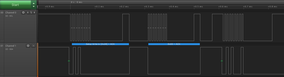

Hi there,
I am attempting to get an STM32F411CE microcontroller to interface with a BNO055 IMU using the I2C peripheral. This particular IMU uses clock stretching which doesn't seem to work with the HAL_I2C library that was auto-generated from STM32CubeMX. See image below:
I attached a second I2C device to the bus and was able to communicate with the library so I'm pretty sure it is only the clock stretching that is causing an issue.
As a reference, here is a waveform of an Atmel microcontroller interfacing with the same BNO055 device and it appears to be working as intended:
Any ideas on what could be causing this issue?

waclawek.jan
Posted on September 26, 2017 at 09:59
How did you post those attachments? I am unable to access them.
Nevertheless, in 'F4 I2C the master clock stretching sense is governed by a parameter in the I2C_TRISE register, see 'SCL master clock generation' subchapter in I2C chapter.
Kyle Klumper
Posted on September 26, 2017 at 17:45
Hi JW,
Thanks for the quick response. I've re-uploaded the images so you should be able to see them now.
I tried modifying TRISE but it had no effect on the waveform. I made sure to modify with I2C disabled as per the reference manual. It looks like the peripheral is waiting until the I2C clock is released by the slave before continuing to cycle SCL, however it appears to ignore releasing the SDA line. Here is the code snippet of the I2C transmit function.

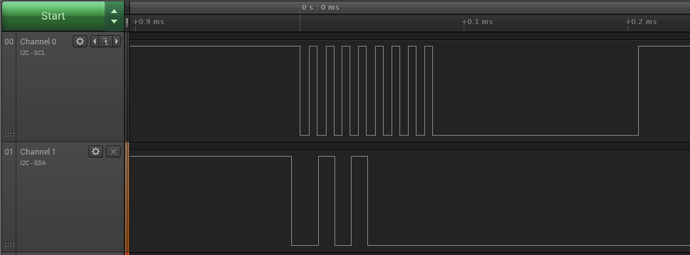

Posted on September 28, 2017 at 17:18
Just an update. It appears the SCL line is not dropping low to finalize the transfer. As a fix, I added a function at the end of each data write to manually pull the SCL line low which seems to get the peripheral working again. Here is the fix:
static void i2c_tx_scl_fix(void)
uint16_t SCL_PIN = GPIO_PIN_8;

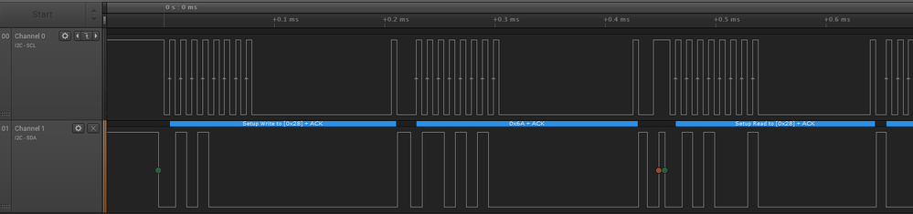

I am still having trouble with the HAL_I2C_Master_Receive function. See waveform below:
Again, the peripheral seems to get stuck in a state that is preventing it from sending the next byte.

Hi everyone, I have exactly the same problem with the stm32f405 microcontroller and reading BNO055 module with i2c.
How should to resolve this problem?
Have you tried the suggestions in the old posts above?
Post your configuration and initialization functions. And any scope or logic analyzer screen shots that show the issue.

I saw the line with a logic analyzer and then I thought may BNO055 keeps the lines low.
