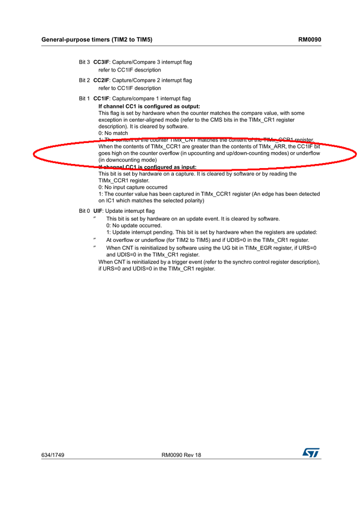

STILL I seem to not fully understand the mechanics:
If I set the the configuration to the following:
  • TIM5->CCR1 = 0x6000,
  • TIM5->CCR2 = 0x7000,
  • TIM5->CCR3 = 0x8000,
  • TIM5->CCR4 = 0x9000,
  • TIM5->ARR = 0x7500
to my understanding the flag CC3IF should never be high... However it IS high after the timer has been reloaded (i.e. after TIM5->CNT == TIM5->ARR)
Please enlighten me :D
