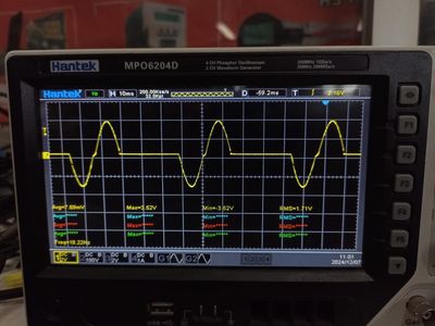

I generated a sinusoidal signal through the DAC using DMA. I understand that DMA performs looping since I use circular mode. In short, I want to control the numbers generated by the DMA. So, when the signal changes to DC (the array contains only 2048 or hold_samples and hold_samples2), it will immediately be detected by my program using the function:
deteksisinyal(void)
 However, I have NOT yet figured out how to control the numbers/results/shape of the generated signal in terms of code. I want to control the signal changes, namely from peak - flat - valley - flat. I will use the flat part for another function, specifically to detect changes in a device. Please, I need help from experts with examples or guidance on what I should do. I will include my code below. Please provide feedback or ask questions about my code.

and the shape of the signal is as follows: and the shape of the signal is as follows:and the shape of the signal is as follows:
Is it possible? I need your help.

MM..1
December 11, 2024
Hi you with DMA require add and use complete callbacks interrupts. Then after half buff is complete you change first half ... or double buffer or more with prepare and switch on full complete...
macam1Author
December 11, 2024
thakn u so much for your response but i have any question:
Can I see when my DC signal starts to form using that method?
I know which array index it starts to become DC, but I can’t control it because I’m confused. Could you explain further?
MM..1
December 11, 2024
Enable IRQ and some on your stream used... only example code
void DMA1_Stream5_IRQHandler(void)
/* Test on DMA Stream Half Transfer interrupt */
if (DMA_GetITStatus(DMA1_Stream5, DMA_IT_HTIF5)) {
/* Clear DMA Stream Half Transfer interrupt pending bit */
DMA_ClearITPendingBit(DMA1_Stream5, DMA_IT_HTIF5);
/* Add code to process First Half of Buffer */
/* Test on DMA Stream Transfer Complete interrupt */
if (DMA_GetITStatus(DMA1_Stream5, DMA_IT_TCIF5)) {
/* Clear DMA Stream Transfer Complete interrupt
* pending bit */
DMA_ClearITPendingBit(DMA1_Stream5,DMA_IT_TCIF5);
/* Add code to process Second Half of Buffer
December 12, 2024
Use a single array to store all values. Splitting it up into a first half + hold + second half + hold isn't congruent with how DMA operates. All values need to be in contiguous memory (ignoring double buffer mode, which is out of scope here).
