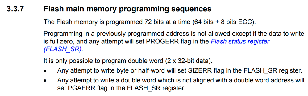

Can stm32l4p5 use Word FLASH Program Type ?
Eakyo.1
According to my research, i cant find word flash program type for stm32l4p5 mcus. There are three diffrent types(DOUBLEWORD,FAST,FAST_AND_LAST). These types defined doubleword.
Thank you for your help.
Guru
No.
Per the reference manual, it is only possible to program the flash a double word at a time.
