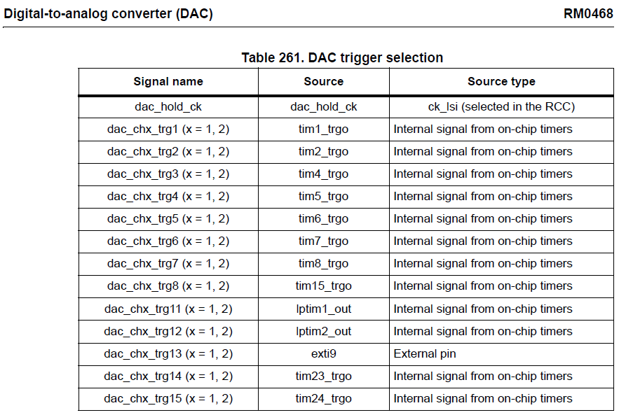

The documentation for the DAC says "A DMA request can be generated when an external trigger (but not a software trigger) occurs if DMA requests are enabled"
But I want to configure the DAC to have no trigger, and instead use TIM12_TRGO to drive the DAC conversion pace, using it as a DMAMUX synchronization input.
Will this work? Or do I absolutely need to configure the DAC with an external trigger to use DMA?

it is not clear which STM32H7 you use.
it is possible to use Timer to trigger DAC conversion.
According to RM0468 Reference manual, STM32H723/733, STM32H725/735 and STM32H730 Value line. DAC conversion may be triggered by TIM1/2, TIM4~8, TIM15 and so on. DAC conversion may also be triggered by external pin: exti9.

It is the STM32H725, but DAC conversion can also be triggered by simply writing to the DAC_DHRx if the TENx bit is 0 (i.e., no trigger).
So my question is, in this case (TENx=0), can the pace of the DAC writes be driven by DMAMUX synchronization?

I suppose, the idea is, to use Timer (such as TIM12) to trigger DMA transfer automatically in a desired period, the DMA will perform transfer from memory (data buffer) to DAC data holding register (such as DAC_DHR12R1), and DAC output is updated in very short time with TEN1=0 (data written into the DAC_DHR1 register are transferred one dac_pclk clock cycle later to the DAC_DOR1 register).
I think this should work.
