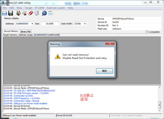

I  got my new board, When I  want to download the .hex file, I tried to use the keil 5.14 and ST-link utility ,failed.
the message I got from the ST-link utility is:Can not read memory? Disable Read Out Protection and retry.
I didn't do anything to the MCU.
the device:STM32F427IG. it's new.
another question:Why I can't read the Flash size?(Unkonwn)
look  forward your help.
thank you

Posted on August 25, 2017 at 17:30
Make sure that you have current drivers and firmware.
Try to upgrade the ST-Link firwmare to the V2-1 version through ST-Link utility or this Link
http://www.st.com/content/st_com/en/products/embedded-software/development-tool-software/stsw-link009.html
Regards
Imen
