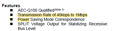

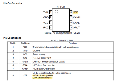

Now there are three points to check:
1- If you are using HSI as source of clock please change it and use STLINK-MCO  as source clock (precise clock) and configure HSE in bypass mode.
2- According to the transceiver datasheet it cannot exceed 1M/s as CAN bitrate. So if you are exceeding this bitrate with FDCAN you will surely face issues.
3- Check the state of STB pin. STB pin should be at 0 level otherwise it will be in standby mode so the node will be offline.

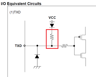

Another important point to consider:
From your tranceiver datasheet: it's a 5V one (VCC Min: 4.75V, Max: 5.25V)
If I consider you supply it with around 5V, you have an issue with TxD pin minimum 'High level input voltage':
VIHmin = 0.7 x VCC = 3.5V > IO voltage level provided by the STM32G0 pin (@3.3V).
Even with VCCmin: VIHmin = 0.7 x 4.75 = 3,325V really at the limit!
PS:
1 - This is NOT an online support (https://ols.st.com) but a collaborative space.
2 - Please be polite in your reply. Otherwise, it will be reported as inappropriate and you will be permanently blacklisted from my help.
What would be your suggestion to overcome this problem?
Simply use 3.3V transceiver or use voltage level shifter for the final project.
But for testing I think there is an internal pull-up resistor connected to the transceiver TxD pin:
Try to configure CAN_Tx pin in Open Drain. But I cannot guarantee this workaround.
