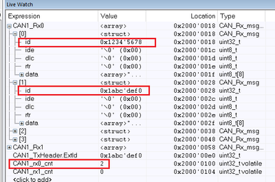

It works well on an STM32F769 NUCLEO board:
This is my IAR screenshot and I'm receiving the two IDs:
Attached the project with which I got this result.
So please double check your CAN config as well as your filter config. Are you using CAN2?
