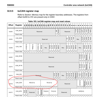

where do i check this counters? It realyy shouldnt be a hardware problem, since the boards i used worked on a previous project. And now i have confirmed, that i recieve data on the RX pin, but there is no data visible on the TX pin, eventhough it shoudl be? (because of the 120 Ohm terminator). Is there a way to recieve CAN data without an interrrupt?
