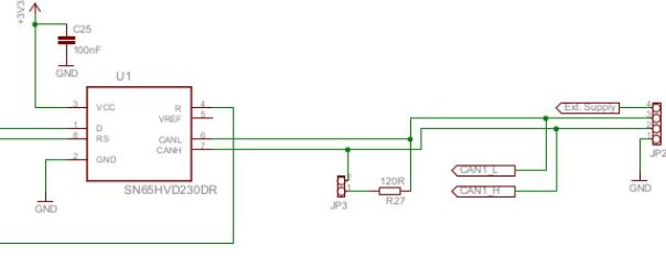

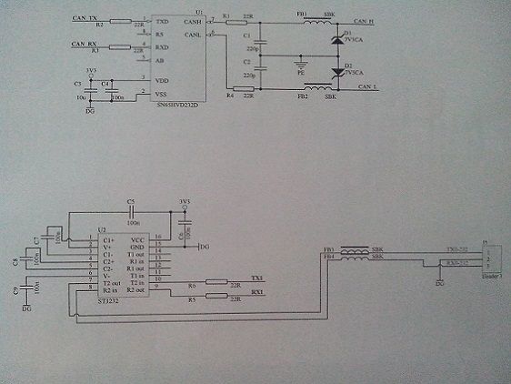

I've never found banging in random values a good way to diagnose problems.Do you have a schematic for this board you're using? Please provide.

i was count and i set 4 for 500 br, and i set same br on converter. I have schema only on paper but i try make it fast on pc

Ok, and if you lose R1 and R4 can just connect the west side to CAN-H and CAN-L of the bus, with a 120 Ohm termination between them, does that function any better?
