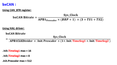

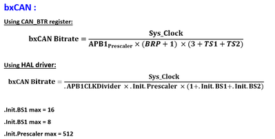

Would someone kindly explain to me how to determine the CAN controller's baudrate for the STM32f769 ?

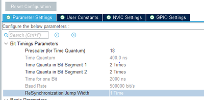

‎2023-12-22 2:19 AM - edited ‎2023-12-22 5:16 AM
Hello @vamshi_kumar ,
This is how to calculate the CAN bitrate on devices featuring bxCAN such as STM32f769.
You can rely on CubeMx to help you to configure the bitrate:
In that case you need to play with different values to match the wanted bitrate.
Also the choice of BS1 (bit segment 1) and BS2 (bit segment 2) should be selected to have the sampling point position between ~75% and ~80%:
So BS1 = ~(75% to 80%) of (BS1+BS2)
The example I provided above with CubeMx (CAN @1Mb/s):
BS1 = 13, BS2 = 4: So the sampling point position in this case: (13 x 100) /(BS1+BS2) = ~76%.
It's also recommended to increase BS1 and BS2 as much as possible and decrease the CAN clock prescaler to match your CAN bitrate.
Hope it helps.

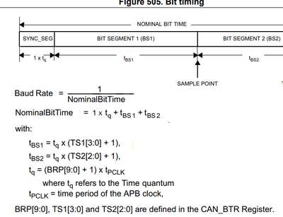

‎2023-12-22 3:16 AM
Thanks for your solution,
But when I am trying to calculate the baud rate value using the formula provided in the data sheet, there is a mismatch for baud rate value which is auto generated by the tool cube ide.
APB clock is 45MHZ.

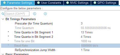

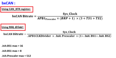

‎2023-12-22 4:11 AM - edited ‎2023-12-22 4:56 AM
No, There is no discrepancy.
See the figure I've already attached:
When you want to do the calculation to set BTR register (using reference manual) you need to use the first formula.
When you want to do the calculation to set the bitrate using HAL or CubeMx you need to use the second formula.
Because in HAL, +1 is added to BS1 and BS2.
In my example: Sys clock is at 216MHz / APB divider = 4 (APB clk = 54MHz), CAN clk prescaler = 3.
If I apply the second formula (related to CubeMx/HAL):
216000000 / 4 x 3x (1+13+4) = 1MHz -> 1Mb/s.
‎2023-12-22 5:54 AM
Updated the figure with updated HAL naming:
The old figure shows the names used in old CAN HAL implementation (updated names in red).
‎2023-12-22 10:37 PM
Thanks for the solution, Its working....
