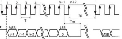

2025-01-04 10:09 AM
I am trying to capture this waveform. Note that it only has CLK and DATA.
2025-01-04 11:08 AM
It looks like the STM32L496’s SPI RX FIFO is either 8-bit or 16-bit.
Would you expect this to capture the above waveform:
hspi3.Init.DataSize = SPI_DATASIZE_10BIT;
uint16_t buf[2];
HAL_SPI_Receive(&hspi3, (uint8_t*)buf, 2, 1000);
2025-01-04 2:03 PM
Yes. Note that the call needs to happen before data is sent. And it will time out after 1 second.
You will have to reconstruct the 20-bit word from two 10-bit words each stored as a uint16_t. Lower 10 bits of each uint16_t will have half of the data.

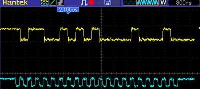

2025-01-14 9:47 PM
Here are the 20-bit signals I’m trying to read.
If I attempt to read two 10-bit words (or two 16-bit words), does the SPI receiver need a Tp microsecond separation between words?
2025-01-15 10:44 PM
I’ve tried reading a pair of 16-bit words and a pair of 10-bit words and the data never lines up with what I’m seeing on the scope.
What if I tried to read that signal with GPIOs? I would interrupt on the rising edge of the CLK and read the state of the DATA pin. Would that work with the 2 MHz clock rate? The system clock is 8 MHz.
2025-01-16 6:52 PM
Your scope screenshot looks OK to me (where it does "never lines up"? SPI mode 0 and it looks OK to me).
No idea what you want to connect (as external slave). But based on the waveform you have provided:
- your external chip wans to see a Tp (a "pause" on the clock), in order to realize a "new transaction" (CMD).
sure, if you do not pause, your external chip might be confused. So, make sure after 10bits sent you provide Tp.
Other then this - I do not see any issue.
For testing it:
- configure the MCU master as bi-directional (full-duplex)
- connect MSIO with MOSI (no external chip)
- and see that you get back what you have sent (check via "loopback" that you get what you send)
2 MHz with "system clock 8 MHz":
No idea what you mean (SPI SYS clock as 8 MHz or entire MCU as 8 MHz? Such a slow MCU?).
If MCU runs core with 8 MHz but you want to handle 2 MHz - and now you think to use GPIO bit-banging for SPI...
How can it work?:
- running MCU with 8 MHz and handling a 2 MHz clock, with GPIO (and INTs) - NO WAY!
--> you need more time for all the instructions (you are just 4x faster on instructions, and you might need
N instructions (assume at least 10), to realize a GPIO signal change
Handling signals as GPIOs and running MCU instructions... your MCU should run at least 100 times faster as the clock you want to process... I do not see any benefit trying to use GPIOs in bit-banging mode to emulate SPI
(esp. when it looks to me you can generate already the 10bit transactions...)
