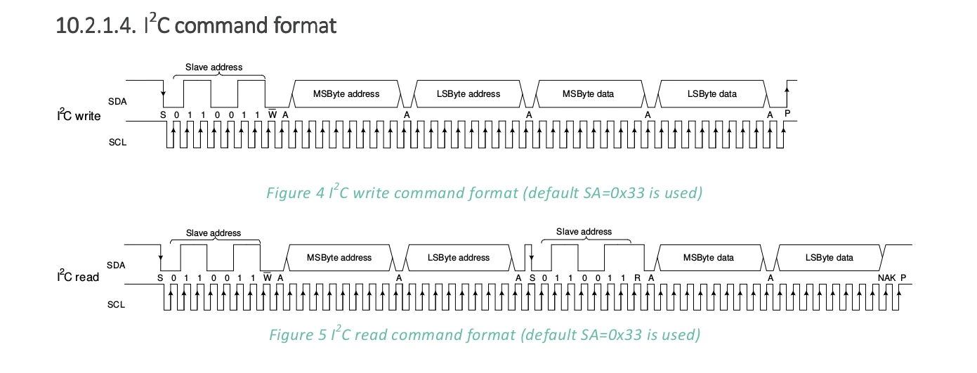

Hello, I try to interface with mlx90640 sensor via I2C. The MCU is STM32F401RE
After reading the bus stays busy. I use LL functions:

The function calling:
Do you have any idea? Thanks!
1 reply
DMako
DMakoAuthor
August 1, 2018
I solved the problem:
put NACK and STOP generating after reading.
