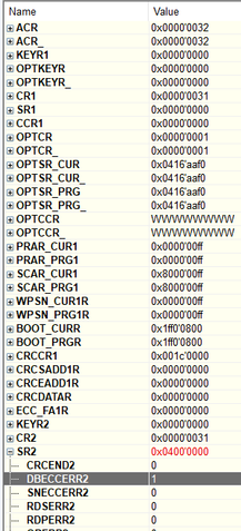

I get a busfault exception when I read bank2 flash memory. I can read bank1 with no issues. From the flash register SR2, it shows as ECC double bit error. This is new pcb and I can flash the hexfile to bank1 successfully.
Even a Jlink memory read showed read error (below SS):
I erased the entire chip using "JFlashLite.exe" and after that it started working normally. Why is this so ? Are we supposed to erase the entire flash for every new MCUs ?

Do a mass erase.
Because the ECC thing can go hairwire. TL;DR. The flash mass erase (aka full chip erase) internally resets the ECC and the flash should behave well until the next disturbance.
What could happen to a new PCB? No idea. May be static electricity, radiation etc., power failure during programming or erase.

Should work fine for all memory you've erased and written. If you're touching memory areas that you haven't written correctly it faulting from ECC failures shouldn't be unexpected.
