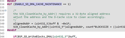

2026-01-06 10:44 AM - edited 2026-01-06 10:44 AM
Can you include your IOC file? I don't see the issues you mention in code generated for the STM32H743. The GitHub mentions some of these issues and says they have been fixed years ago. It's possible you're generating code with an old version.
"0x3" doesn't appear anywhere in the generated sd_diskio.c and it seems like the generated code is correct here (0x1F instead of 0x3):
The file only has 520 lines so I'm unable to compare lines 556-561.

2026-01-07 6:26 AM
I've attached my IOC file.
Seems I'm on FW_H7 V1.11.2 - a version from March 2024.
I tried updating to V1.12.1, and the sd_diskio.c does have the bugfixes.
It also rearranges HAL code directories and breaks my build, which I haven't got time to fix right now. But, looks like the SD card driver has indeed been fixed.
