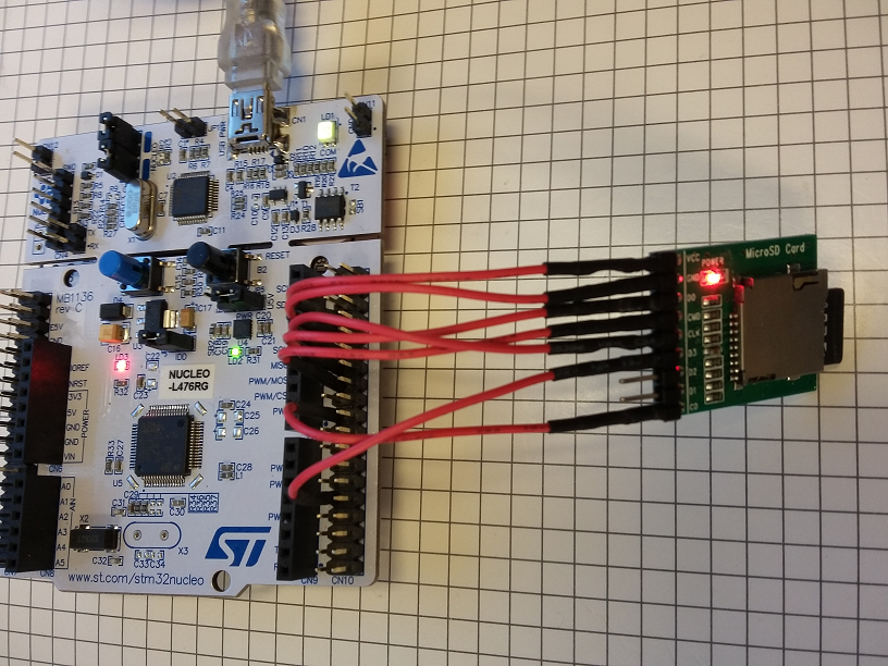

2018-02-02 12:28 PM
\STM32Cube_FW_L4_V1.0\Drivers\BSP\Adafruit_Shield\stm32_adafruit_sd.c
Issue with ReadBlocks/WriteBlocks on SDHC cards, offset advances in BlockSize!!! ReadAddr should increment by 1. The current routine delivers junk for multi-sector reads/writes. Please, please, test these things, wasted a lot of time chasing this to ground.
Original code
response = SD_SendCmd(SD_CMD_READ_SINGLE_BLOCK, (ReadAddr + offset) * (flag_SDHC == 1 ? 1: BlockSize), 0xFF, SD_ANSWER_R1_EXPECTED);
/* Set next read address*/
offset += BlockSize;Suggested fix (I'd probably refactor completely)
response = SD_SendCmd(SD_CMD_READ_SINGLE_BLOCK, ReadAddr * ((flag_SDHC == 1) ? 1: BlockSize), 0xFF, SD_ANSWER_R1_EXPECTED);
ReadAddr++; // Block Address
offset += BlockSize;Original code formatted

2018-02-04 7:57 AM
Large f_read()/f_write() used against the FatFs library will propagate to the DISKIO layer as reads/writes where count>1
Failure can be observed in a file CRC routine if >=1024 byte blocks are read vs 512 byte blocks. Different CRC values will be observed in 512, 1024, 4096-bytes/block, etc, passes of the file.

2018-03-15 4:18 AM
Hi Clive,
The issue you highlighted was reported internally and confirmed. The fix will be available in coming versions of the STM32CubeL4 package.
-Amel
2018-07-26 5:51 AM
Hi @Community member ,
Please note that a fix is applied to BSP_SD_ReadBlocks and BSP_SD_WriteBlocks in order to support SDHC cards. Updated stm32_adafruit_sd.c is available in the last version of STM32CubeL4 package (1.12.0) .
-Amel
2024-06-04 8:52 AM
There is a problem with sd_spi implementation in stm3210c-eval-bsp/stm3210c_eval_sd.c The fix related to thread is applied only on Drivers/BSP/Adafruit_Shield/stm32_adafruit_sd.c not on evalboard BSP. Please fix this.
