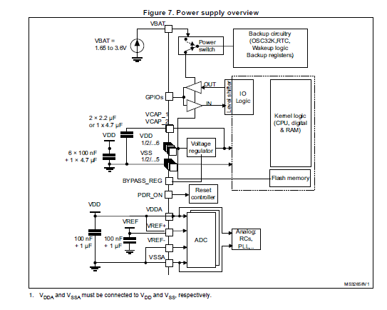

‎2023-06-01 7:06 AM - edited ‎2023-11-20 4:19 AM
Hi Diane,
I understand your point but there is a PDR (power down reset) present in STM32F MCUs. It states that Vbat Voltage will be switched to Vbat external battery voltage if Battery is present, Otherwise it will use VDD (see the figure below). Please correct me if my understanding is wrong.

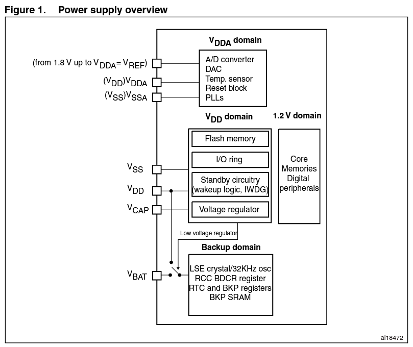

‎2023-06-01 7:43 AM - edited ‎2023-11-20 4:20 AM
Hi @TALHA​
It's not in this sense that it works the Back up domain can be powered by the VDD or the VBAT by default it's on the VDD. When the VDD drops below the selected VBOR threshold, the VBat takes over and feeds the domain backup. By leaving your VBat pin floating, you're in a configuration in which we can't guarantee the product's proper operation.
If you don't have anything to maintain in the backup domain, you can connect your VDD to your VBAT.

‎2023-06-01 7:58 AM
@TALHA​
I don't think it's necessary to redo your card, if the VBAT pin is not floating.The only imperative is that the VBAT pin is not floating, if it is connected to an external battery or even a VDD there is no problem
If your battery is empty you will just lose the contents of your backup domain.
