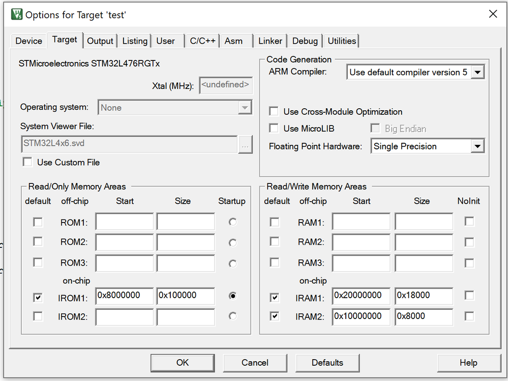

I'm trying to get the dual boot to work on STM32L476RGTx. I'm using Keil MDK with compiler version 5. I wrote a simple blinky code that toggles LED on GPIO pin every 500 ms. Initialisation code and project were generated with CubeMX. After build I generate bin file from elf according to Keil documentation.

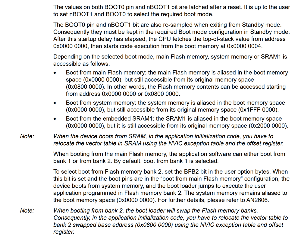

Hey! I know that L0 devices doesn't switch banks but the L476 should. Attached are relevant sections of documentation.

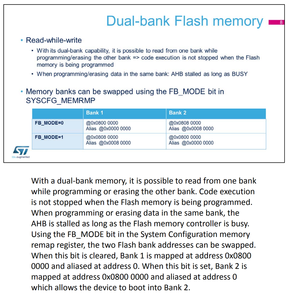

From STM32L4 flash presentation.

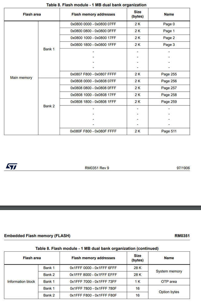

Dual bank flash organization for my device.
Boot modes for my device.

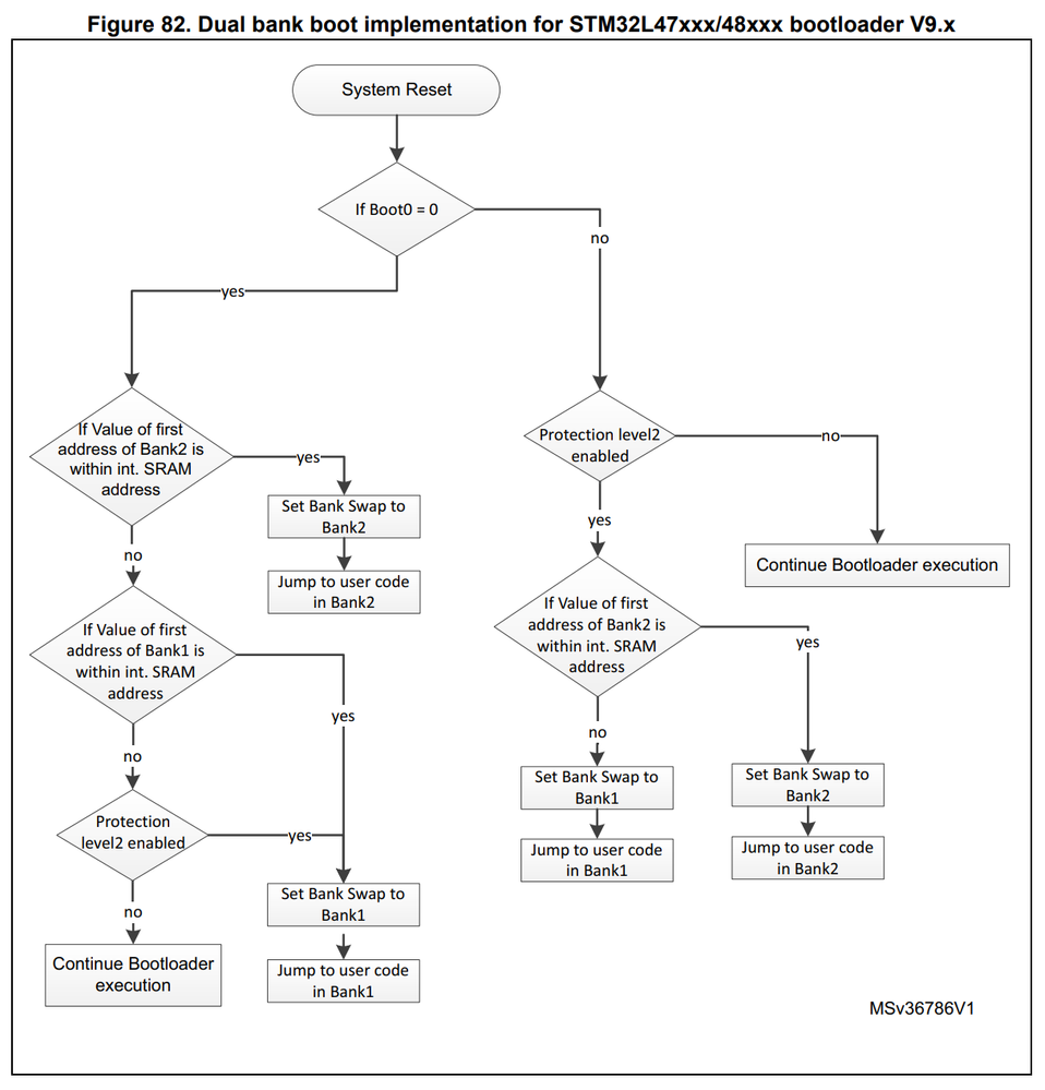

How the bootloader works.

Figured out what's wrong.
In file "system_stm32l4xx.c" I had to uncomment "#define USER_VECT_TAB_ADDRESS". After the bootloader started my code the vector table didn't get remaped. At systick interrupt the cpu jumped back to bootloader and code restarted.
