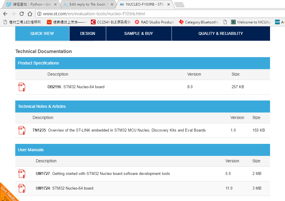

Posted on June 07, 2017 at 15:04
http://www.st.com/content/ccc/resource/technical/document/user_manual/1b/03/1b/b4/88/20/4e/cd/DM00105928.pdf/files/DM00105928.pdf/jcr:content/translations/en.DM00105928.pdf
Generally, you just google the name of your  dev board, like ''nucleo 32 stm32F103'',
then jump to the product page in st website, such as
http://www.st.com/en/evaluation-tools/nucleo-f103rb.html
then you will see all the docs you need/want to know
like this:
you will do this quite often I guess! Have fun with your nucleo board!
