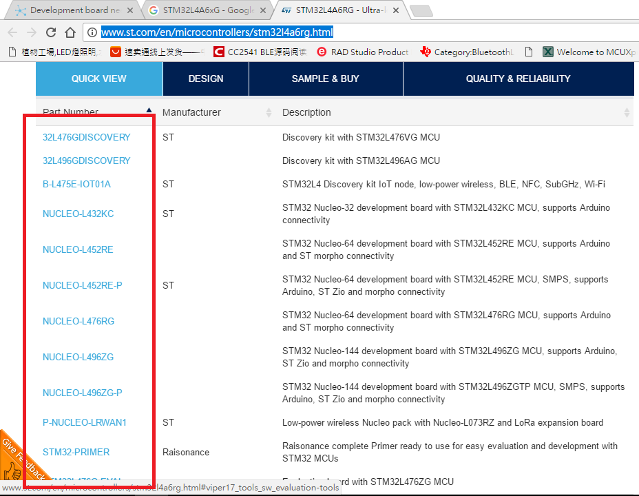

In the following page,
http://www.st.com/en/microcontrollers/stm32l4a6rg.html
Click evaluation tools.
You will  see so many dev kits, is that what you want?
Hope that helps!
