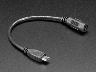

You could even power the board via the ST-Link USB connection using a USB power supply or power bank.
eg, via a lead like this:
USB specified 5V power - so you just need a 5V power supply.

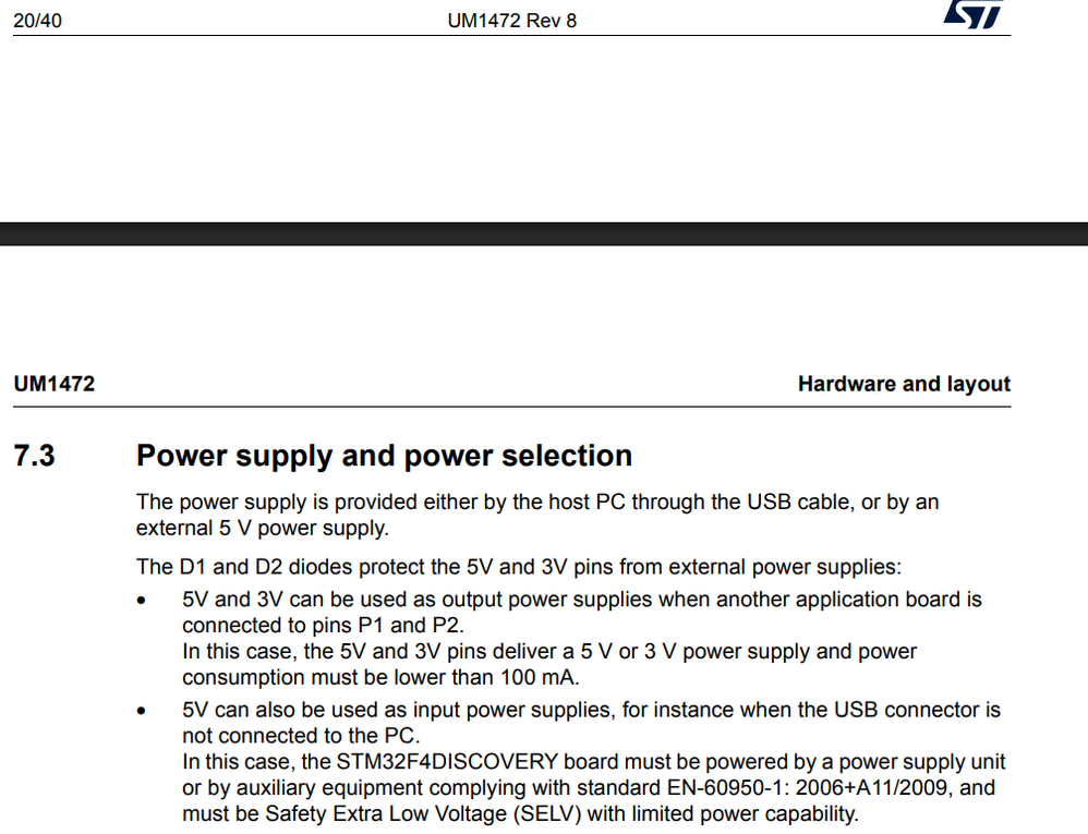

You need to read the User Manual for the Board:

Hello @cockatoo
You need to configure your board to be powered from an external power supply
you can refer to the section 7.4 of this user manual if you have the LQFP144 package

As @Gyessine said, the User Manual for the board will tell you what its power input options are, and the specifications for each option.
So you just need a power source which meets those specifications.
