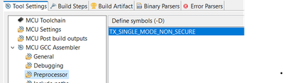

regarding the missing functions you mention (_tx_thread_secure_stack_context_save, etc), did you define TX_SINGLE_MODE_NON_SECURE for C compiler AND also for the assembler ?

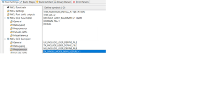

Hi Guillaume, I was doing one silly mistake. Actually I didn't included TX_SINGLE_MODE_NON_SECURE for the assembler.
Now,
  1. _tx_initialize_low_level() is not commented.

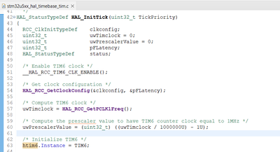

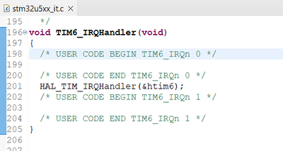

  1. using additional timer TIM6 instead of SysTick for HAL tick.
  1. TX_SINGLE_MODE_NON_SECURE=1 is included in C compiler and assembler.
tx_thread_secure_stack_allocate/_free.c, txe_thread_secure_stack_allocate/_free.c, tx_thread_secure_stack_initialise/_build.s included(as I am able to compile my code.

TIM6 should be higher priority than PendSV (so for example 14).
