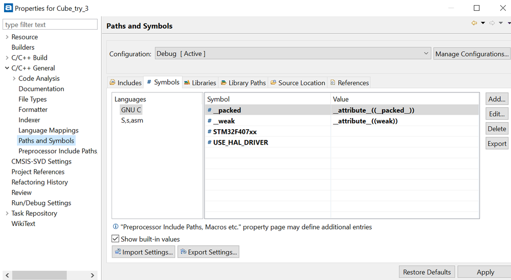

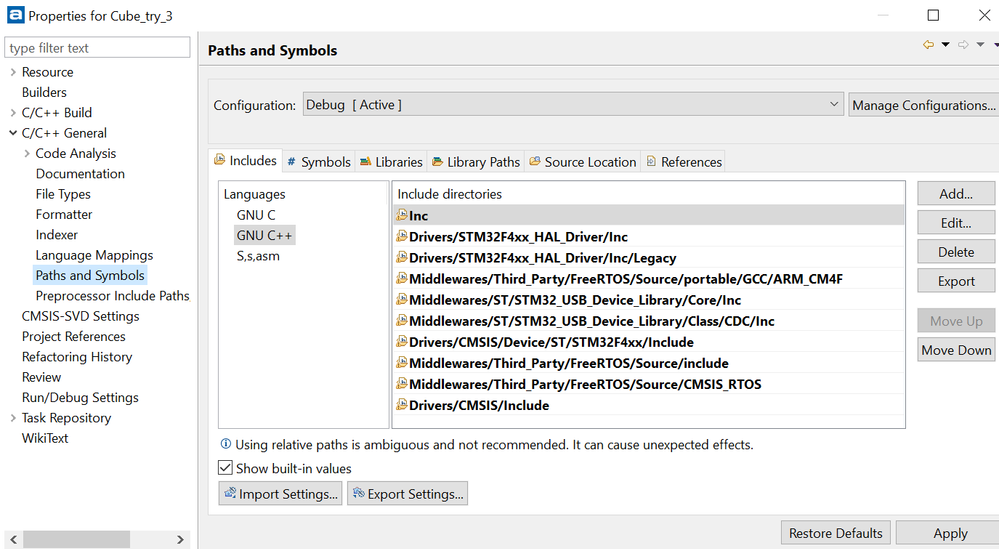

Serious Bug 1: In Properties -> C/C++ General -> Paths and Symbols:
The Includes tab has added GNU C++ in the Languages column as it should.
Bug: In the # Symbols tab, GNU C++ is not added in the Languages column.
The additional language should be added, and initial values copied from the C language.
Extremely Annoying Bug 2: In Properties -> C/C++ General -> Paths and Symbols:
Unfortunately, it is blank, where it should be initialized to a copy of the C language settings.
User has to copy and paste the entire list! Please fix initialization...

2018-11-15 7:16 AM
Hello Dave,
When converting a C project to C++ there will be some configuring work needed. It's also noticed more when it's a project generated by CubeMX because we set up C++ for you in a project generated by TrueSTUDIO but never use it until the c++ nature is added to a project, then you only need to do the manual work for anything you've configured.
Includes and Symbols are not copied from C to C++ compiler automatically, it will require manual work.
Easiest way of doing this is actually by going here:
C/C++ Build > Settings > Tool Settings > C Compiler > Symbols.
Copy all lines to the corresponding C++ Compiler > Symbols.
Do the same batch copy for the Include paths.
It will hopefully speed up the process and make it less frustrating.
