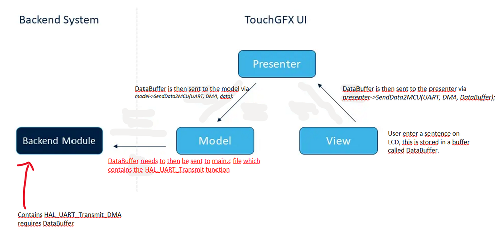

These strings: extern uint8_t RX1_String_cpy[512] are for the HAL_UART_Receive which are found in the main.c file. They are being exported to model so that the received strings can be displayed on the LCD.
What I want is the reverse direction (send data from UI to main WITHOUT RTOS). I want to get the string entered from the user on the LCD and send it from model to main. That's my problem right now.

Now in the model.cpp file, what can I write to send the function SendData2MCU(UART, DMA, DataBuffer) to main.c?
redmig
I might miss something.. but define your pointer to the buffer in main and export it to the model.
from the model fill your buffer with data.. and you have it in the main. or not?
I have added a picture which represents how touchgfx LCD works with the backend module (main.c). The text in red is what's missing for me. I do not know how to send the function SendData2MCU from model.cpp to main.c file.
What should I write? main->SendData2MCU ?? This does not work...
