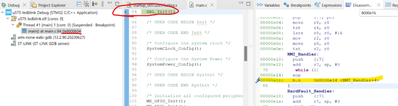

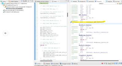

I tried to debug the application during FW upgrade. The upgrade happens successfully but when booting new firmware, the code fails at 0x08000e16 flash address. I then flashed the new firmware separately in debug mode to check what code is present at this address and I see that the code runs into NMI handler. I am not sure how to debug this further.
I also checked the reset_handler, and the stack pointer is pointing to correct flash address.
for RTOS protection I also added vTaskSuspendAll(); in JumpToBootloader.
Additionally, I tried to deinit all the peripherals manually in JumpToBootloader. Still no luck.

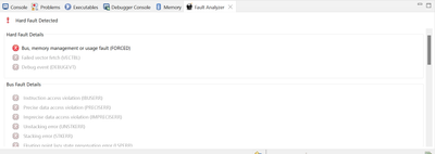

1. I cannot view the call stack as after upgrade, the FW is different than the one I put in debug mode.
2. I am seeing "Bus, memory management or usage fault" in the fault analyzer.
3. I tried to look at fault status registers and following are the values I got.
CFSR Value: 0x20000
HFSR Value: 0x40000000
MMFAR Value: 0x200bffa4
BFAR Value: 0x200bffa4

In the screenshot you posted, execution is paused at the HAL_Init line. It's not in the error handler. Maybe it goes there if you unpause, but nothing is abnormal in the screenshot.
2024-09-08 11:07 AM
The screenshot I posted is of the New firmware that gets flashed. The base firmware is entirely different than the upgraded FW.
I had flashed the base fw and started the debugger. I did the FW upgrade and then the code halted at this address. To check what code is present at that address I had to reflash the new FW separately (through ST link and not FW upgrade) and check disassembly at that address. That is what I have posted.
