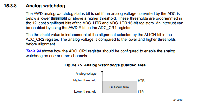

Hi @PSmol.1​ ,
Can you check the higher and lower threshold of the analog watchdog ?
If you get the analog watchdog interrupt, it means that the value is below the lower threshold or above the higher threshold value.
Please find attached the corresponding Reference Manual.

‎2022-10-03 8:16 AM
Thanks for your response!
The lower threshold is 0, meaning it is a given that the upper threshold was triggered.

‎2022-10-03 8:30 AM
Once the analog watchdog triggered :
- Can you check the value in the register ADC_CR ? It contains the latest value converted.
- What is the value of the register ADC_DR ? It provides an image of the status bits of the different ADCs
Thanks
A.MVE
