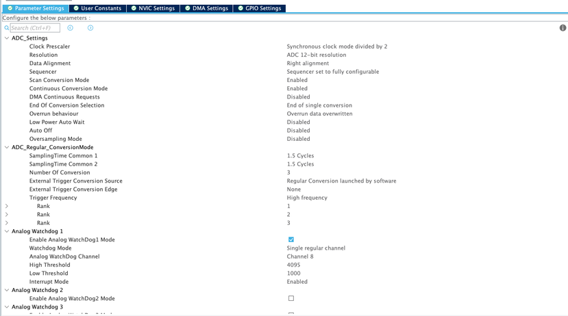

I'm working on some code to wake up from Sleep or Stop mode when a low ADC value happens.
I found this post which gets me almost all the way there https://community.st.com/t5/stm32-mcus-products/what-is-the-process-to-use-the-adc-on-stm32f745-to-wake-up-the/td-p/91522
I'm able to get an interrupt to trigger on a low ADC value while in sleep mode but the main loop does not restart. The main loop does restart when I trigger an interrupt from a digital GPIO.

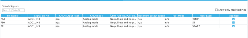

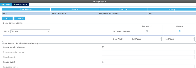

Here are the relevant parts of the .ico file configuration

 The interrupt handler for the ADC watchdog looks like this
bool wakeup=false;
void HAL_ADC_LevelOutOfWindowCallback(ADC_HandleTypeDef* hadc)
	wakeup=true;

On a side note. Not sure if this is relevant information or not. When the device is operating normally I want the ADC to be done with a DMA that is started at the end of a PWM cycle. So I have an interrupt that triggers on the PWM and that starts the DMA. Once the device is turned off by the end user it will need to be in a sleep or stop state and should wake up on the ADC low value trigger. This happens when the device is plugged in for charging. The other time it would wake up is when the user pressed the button which also triggers an interrupt.
