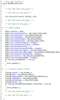

And the programming, using the HAL drivers:
//Additional initializations beyond HAL implementation
	HAL_ADC_Stop(&hadc1);
  	HAL_ADCEx_Calibration_Start(&hadc1, ADC_SINGLE_ENDED);
//Battery checker, in main loop
	if(check_adc && ((hadc1.State & HAL_ADC_STATE_READY) == HAL_ADC_STATE_READY))
		//Configure ADC for conversion
		adc_channel = TP_ADC;
		sConfig.Channel = adc_channel;
		sConfig.Rank = 1;
		if (HAL_ADC_ConfigChannel(&hadc1, &sConfig) != HAL_OK)
			Error_Handler();
		if (HAL_ADC_Start(&hadc1) != HAL_OK)
			Error_Handler();
		if (HAL_ADC_PollForConversion(&hadc1, 100) != HAL_OK)
			Error_Handler();
		if (HAL_ADC_Stop(&hadc1) != HAL_OK)
			Error_Handler();
			Error_Handler();
			Error_Handler();
		uint16_t temmp = hadc1.Instance->DR;
		check_adc = NO;
		adc_check_timer = ADC_CHECK_TIME;

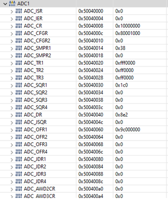

Registers while device is paused, currently a floating pin:
And measured results of the DR register:
Pin grounded: 0x7C0
Pin floating: 0x8E2
Pin 3.324V: 0xFBF

The ADC channel could be in differential mode. Are you missing sConfig.SingleDiff = ADC_SINGLE_ENDED? Or other members of sConfig? That part of your code isn't shown.

Read out and check/post content of ADC registers.

This is single-ended, and configured as such.  I did post a screenshot of the ioc setup, I'll amend my original post with this information.
I'll give it a shot, couldn't hurt.  I *can* tell you I've compared my code to several of the sample projects for ADC, as well as comparing with code written by my boss on a different project, and the code looks correct.

I agree something seems fishy here, and that would be a nice solution, but alas, it is very much configured in single-ended mode.
I'll post a screenshot (or a few) of my register readouts for ADC1 and ADC123_Common in the original post.

As above, definitely configured for single-ended.
OK so you've posted a screenshot, where ADC_SQR1=0x1C0, i.e. one conversion and that's on channel 7; and ADC_DIFSEL=0x80, which means the conversion on channel 7 is differential.
The mcu does not work out of what you've clicked in CubeMX, it works out of the registers' content.
So I guess when you configure one channel, you don't configure them all ;)
Thank you so much for that!
At ground, measuring 0x000.
