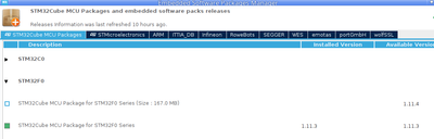

Did you try to up- or down- grade the software pack:
(in IDE, in edit ioc -> CubeMX-> manage software packs ...) then you see this;

I removed the most recent install and installed the previous software pack. Didn't work, sadly.

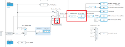

‎2023-12-21 5:37 AM
Could you please change your system clock frequency to 48MHz instead of 8MHz as following and use PLL?
Your ADC clock is coming from HSI which is 14MHz. So I suspect an issue on the ratio between the two frequencies.
