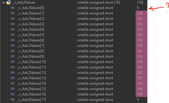

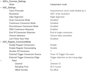

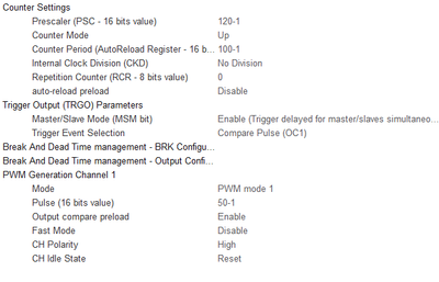

Using ADC2, one channel IN12, triggered by timer every 100µs, using circular DMA sized of 16 half-words, the array [0] value is always 0, the array's index used by DMA is from 1 to 16, not 0 to 15. See below screen shots :
code :
volatile uint16_t _v_Adc2Values [18]; // Define to 18 to see the shift
HAL_ADC_Start_DMA (&hadc2, (uint32_t *) _v_Adc2Values, 16);
HAL_TIM_Base_Start_IT (&htim15);
result :
When I starts my software this morning to make the screen shots, the 1st start, I have not the issue, the values comes from 0 to 15 in array. Then I restarted my software several times, and all these tries the array result was shifted like the screen shot.

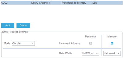

I think the DMA settings are missing in your description.

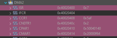

I would check and compare the relevant DMA register contents for both cases, i.e. before and after a restart.

Not exactly. The values have shifted within the array.
Which indicates the DMA target address has changed.
lclor
I would like to say that values are written by DMA in array from index 1 to 16 instead of 0 to 15.

In this case, it is a defined number of 16-bit transfers from a fixed source to an auto-incremented target address.
After the defined number of word transfers are done, the DMA transfer is finished.
In circular mode, which I suppose is in effect here, these whole procedure restarts with the next ADC_EOC / EOS event, and at the initial target address.
The transfer size, number of transfers and initial target address have to be configured by your code.

DMA register CMAR is correct, it's the _v_Adc2Values [0] address.
