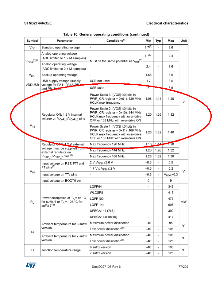

I am working on Power Reduction and we are using STM32F446RE Microcontroller.
In the RM i found this,
"the regulator output voltage (around
1.2 V) can be scaled by software to different voltage values (scale 1, scale 2, and scale
3 can be configured through VOS[1:0] bits of the PWR_CR register)."
so, my question is what is the regulator output voltage at scale 1, 2 and 3. is it less than 1.2 v? if i run my microcontroller at 80Mhz, then selecting scale 3 would reduce the power consumption ?
Thanks
waclawek.jan
Yes.

T J
Lead
How about you test it and let us know ?
if the core voltage is lower then the power will be lower.
however, you must have approx 1.2V for everything to work correctly.
( 2 transistors in series need 1.1-1.2V to work correctly)
the closer you get to that threshold, the more susceptible you will be to 'noise resets'
