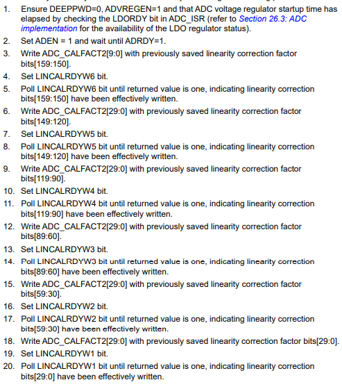

About the calibration of the ADC on STM32H747
HTess.1
I am currently trying on the linearity calibration and I am following the protocol (down below) but I do not understand where I am supposed to get the saved linearity correction factor bits[159:150] (step 3)? Every single ADC register is 32 bits at most..
1 REPLY 1
FBL
Hello @Community member​,
Can you explain more the need,
 LINCALFACT[29:0]: They hold 30-bit out of the 160-bit linearity calibration factor.
To control the linearity correction (6 words), we poll bits until returned value is zero. For that reason, 10-bit of the last word remains [159:150]
Best regards,
FBL
