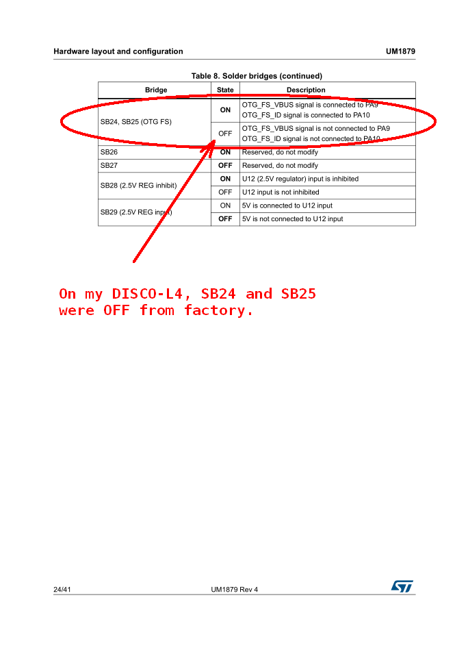

32L476GDISCOVERY manual - default state of SB24/SB25

Hello @Community member​ ,
You are right, this seems to be an error in UM1879. Those bridges (SB24, SB25) should be OFF.
We will make sure table 8 is corrected in next version of the UM1879.
