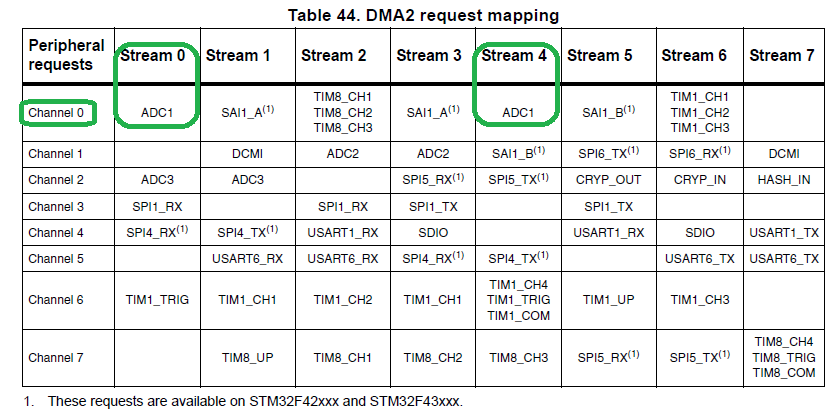

Posted on January 04, 2014 at 22:51
I would like to sample 2 analog channels with 100kHz (STM32F429 disco). I found examples only with one channel. I tryed to edit it, but my code dont work. If I placed breakpoint into DMA2_Stream4_IRQHandler() , program never break there. thanks for help

Posted on January 05, 2014 at 02:14
For C++ make sure the IRQHandler's name isn't mangled (check .MAP, and vector linkage)
Also
if
(DMA_GetITStatus(DMA2_Stream4, DMA_IT_TCIF0))
That should be DMA_IT_TCIF4 shouldn't it? Is it even Stream 4? I'd have to check the manual, but my other 2 Channel (same sample point) example used Stream 0.
/public/STe2ecommunities/mcu/Lists/cortex_mx_stm32/Flat.aspx?RootFolder=https://my.st.com/public/STe2ecommunities/mcu/Lists/cortex_mx_stm32/ADC%20in%20Dual%20Mode%20Simultaneously&FolderCTID=0x01200200770978C69A1141439FE559EB459D7580009C4E14902C3CDE46A77F0FFD06506F5B&currentviews=404
raptorhal2
Lead
ADC1 is on Channel 0, Stream 0 or 4. See RM00090 Rev 5 Reference Manual, Table 44.
Cheers, Hal
Posted on January 05, 2014 at 02:19
Yeah, Stream4 should be fine.
raptorhal2
Lead
Posted on January 05, 2014 at 03:08
Just to clarify - Tomas' code is attempting to use Channel 4.
Cheers, Hal

Posted on January 05, 2014 at 08:11
You mix variable definitions, with function calls, this is a very C++ construct, so just checking.
As Hal highlighted, and I diagrammed your real problem is the Channel4 is not usable as it has NO connectivity to ADC1
Further if you use Stream4 then you need to be examining the TC4 flags, as they are interrelated.
You can define the body for the IRQHandler functions in any source/objects files you choose, the linker resolves that.
C++ mangles names based on parameters, so the linkage would not occur, and the weak definition would prevail.
tom23
Posted on January 05, 2014 at 09:08
I mixed up ''stream'' and ''channel in stream''. I fixed it, but the code still doesnt work. Program never break on breakpoint in DMA2_Stream4_IRQHandler.
I am not sure of size of ADCConvertedValuetoo.

Posted on January 05, 2014 at 14:09
Size appears correct, it's in units of transfers, not bytes
DMA_InitStructure.DMA_PeripheralInc = DMA_PeripheralInc_Enable;
No, don't do that you want it to remain pointing at ADR1->DR, the timer triggers the ADC start, the ADC EOC triggers the DMA
