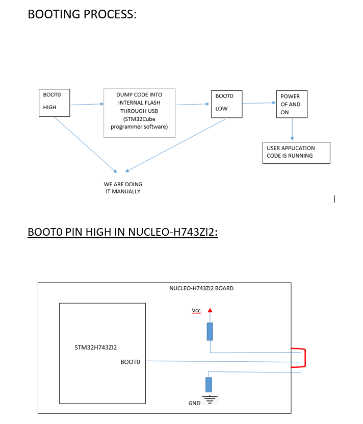

1.board-NUCLEO-H743ZI2 . we are dumping code into flash externally through USB .for that we are making boot0 pin high and low manually.is it possible to make boot0 pin high and low in software. I don't have access to change boot0 pin in MX.
SChan.23
we are not able to change boot0 pin in MX configuration. for other input output pins we are able to change the configuration but not for boot0 pin.
Thanks in advance.

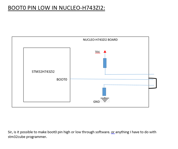

SChan.23
sir,
please find the attached image related to booting process.i understood your reply but not completely. could you please eloborate it.0693W00000WIO0nQAH.png0693W00000WIO0YQAX.png
gbm
Principal
You can't set the state of BOOT in software but you may easily invoke the builtin bootloader from your software. That's what was written above - just do it.
