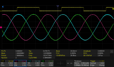

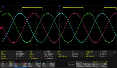

The motor I'm using, according to the datasheet, uses a 120 degrees configuration with a phase shift of 120 degrees. And that is the configuration I used to initial testing. But phase current waveform showed something weird at one side of the hall sensor steps. Then I plotted motor phases and hall sensor signals while manually rotated the motor and realized that the placement of the hall-effect sensors in the specific motor I had in my hands, had a phase shift close to 108 or 110 degrees.
This is the plot for FORWARD:
and this is the plot for BACKWARD:
This is due to a bad manufacturing tolerance in the hall-effect sensor placement inside the motor.
I have added the plots because they illustrate that the same phase shift offset needs a delay in one motor direction and an advanced commutation in the other.
