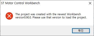

0693W00000SuntYQAR.jpgWhen I open the 'Potentiometer_ESC-G4.stmcx' file through 'Load Project' in 'MotorControl Workbench 5.4.8', an error message as shown in the picture pops up.
Please edit Potentiometer_ESC-G4.stmcx and change line 5:
  • from <version value="5.90.0.0" />
  • to e.g. <version value="5.04.02.01" />
Regards
/Peter
