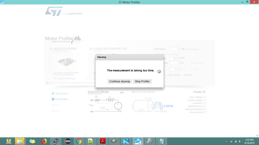

I have a Nucleo - F302R8 board with X-Nucleo - IHM07M1 BLDC motor driver. I'm trying to drive my bldc motor which is Emax rs 1106 - 6000kv using motor profiler software.
Using the motor profiler software with suitable settings (pole pair = 6 , Max Speed = 16000, Max current = 1.7 , Vbus = 8V) the motor isn't able to rotate.
I've used other bldc motors like BR2804-1700KV and DYS 1100KV and they worked fine.

Dear Claire ,
  • Yes the problem happens during the motor profiling.
  • No the motor profiler isn't able to determine Rs, Ls and Ke values.
  • No errors.
  • The electric model reaches up 38 % every time and pops a warning message saying "It gives a pop up window saying "The measurement is taking too time.""
I have tried decreasing the speed to 7000rmp and current to 1A but nothing changed.
I will attach the screenshots in hope that it might help.
The profiling stops at around 38 % of electrical modeling status and then prompts this message below
Even after clicking "continue anyway" the motor doesn't run.
