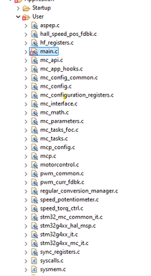

@Karl Yamashita do you know where can I find this function? In the main.c or in which archive?
(This photo is from a computer that can not debug the code, just to see it).
No i don't know where that function is in what file. You can place your cursor on the function and press F3, which will jump to that function.
If a reply has proven helpful, click on Accept as Solution so that it'll show at top of the post.
CAN Jammer an open source CAN bus hacking tool
CANableV3 Open Source
@Karl Yamashita but if i do not find the function I can not put my cursor on the function and press F3. I am sorry, I do not know if I am understanding it incorrectly.
You've posted this code, so you do have the function MC_ProgramSpeedRampMotor1 to place the cursor on
